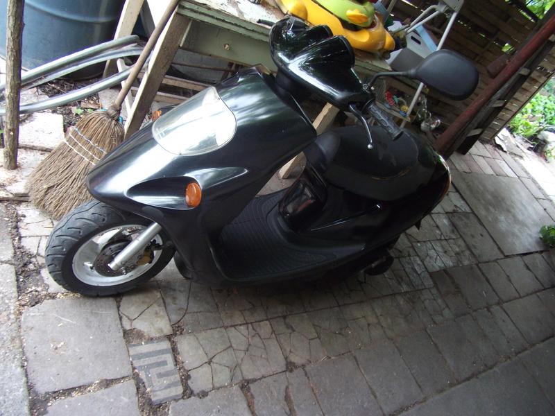

Kispaksi2014-05-22 15:21:27 // 145498
Sziasztok! Van egy picit megpiszkálgatott közepes testű Malaguti robogóm. Ha valakinek van 156 hoz valami kiegészítője,sokküllős felnije vagy bármi amit az autó kapcsán fel tudok használni és árban egyezik azzal szivesen elcserélném. A motor napi használatban van, fogyasztás 2 liter alatt városban is. 80as órát simán kiakasztja. Ugyan azzal a festékkel lett átfújva mint a 156om :)http://www.alfaamore.hu/files/sitetemp/t-1400764557-6961-72471-forum.jpgBull882014-05-22 11:34:00 // 145497

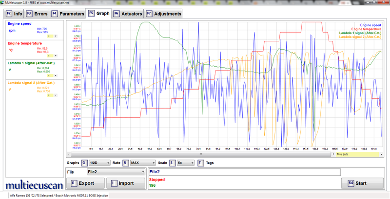

Akos_2014-05-20 09:49:28 // 145473
Sajnos rendszeresen kapok hibakodokat a 2002-es JTS-emben.
Alltalaban csak ezek vannak:
P0120
P1121
De tegnap tobb is volt.
Tudtok ajanlani egy budapesti szerelot aki nem rest es megkeresi a hiba eredeti okat es kepes megszuntetni azt?
Koszi
P0134: The code is set when there is an open or a short in the Lambda Sensor heater relay circuit indicated by the code. This slows down the Lambda sensor in reaching the operating temperature. Check the relay, connectors and wiring between the relay, ECU and the power supply.
The reason for this fault is that ECU did not receive signal from the sensor. The fault is present now. Take appropriate action to fix this sensor fault. Dashboard warning light was activated for this fault.
ERROR DETAILS:
Engine temperature: 30,8 °C
Engine speed: 1040 rpm
Engine load: 44,25 %
Air temperature: 19,5 °C
Throttle position: 4,31 %
Battery voltage: 13,303 V
P0120: The idle speed actuator is equipped with a sensor sending its positioning to the ECU. The anomaly concerns this information which is inconsistent with the functioning conditions or is out of the allowable tolerances
Check wirings and connections before any replacement.
The reason for this fault is that ECU has received invalid signal from the sensor. The fault is not detected now, but it is stored in memory. Clear fault codes, and observe for future appearance of the same fault. Dashboard warning light was activated for this fault.
ERROR DETAILS:
Engine temperature: 72,8 °C
Engine speed: 2000 rpm
Engine load: 68,25 %
Air temperature: 18,8 °C
Throttle position: 14,90 %
P1122: No help available
ERROR DETAILS:
P1121:
ERROR DETAILS:
Engine temperature: 90,8 °C
Engine speed: 2240 rpm
Engine load: 43,50 %
Air temperature: 37,5 °C
Throttle position: 10,59 %
Battery voltage: 13,159 V
Ezutan ramertem a lambda szenzorokra itt vannak a kepek:
ERROR DETAILS:
P1121:
ERROR DETAILS:
